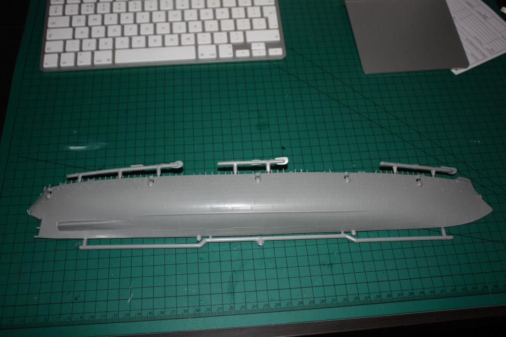

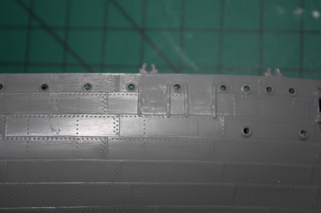

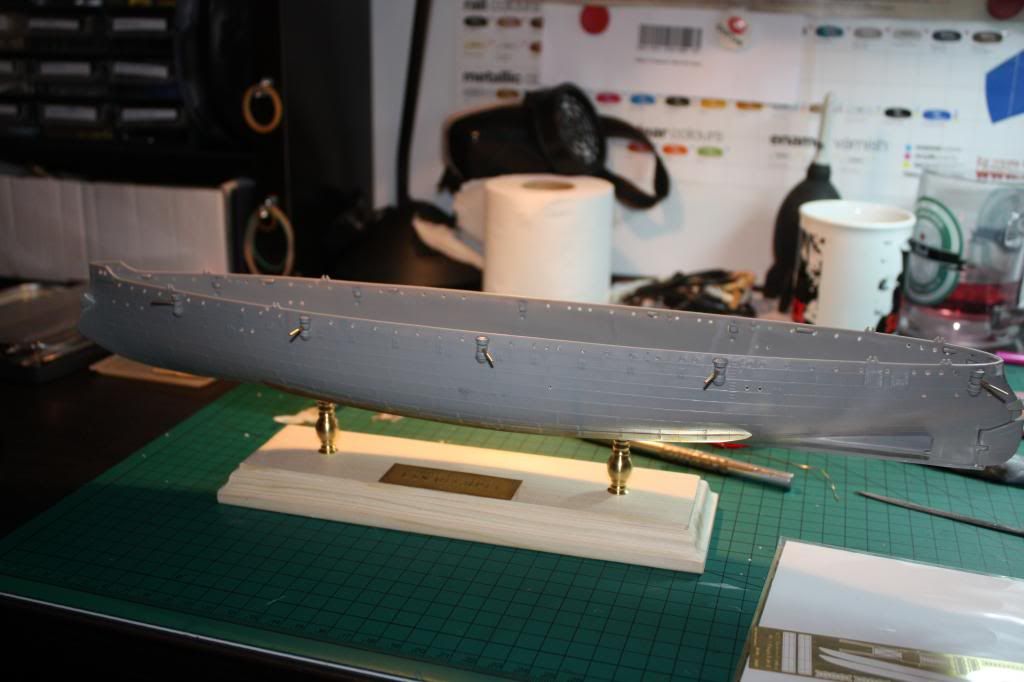

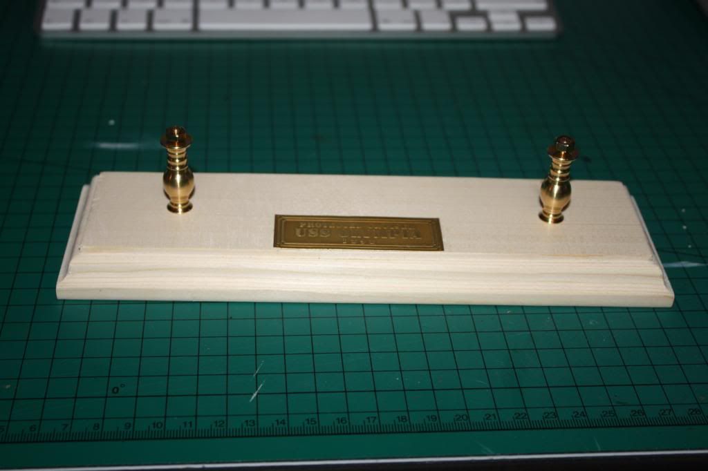

Build kicks off with the base. The supplied base is a piece of pine with two solid brass stands. I simply rubbed down the wood with micro mesh and sealed with a matt coat of varnish. The holes were pre-drilled so the stands could just be screwed in and the etch name plate was attached using Zapp Gel CA which gives you a bit of time to place the etch before it sets.

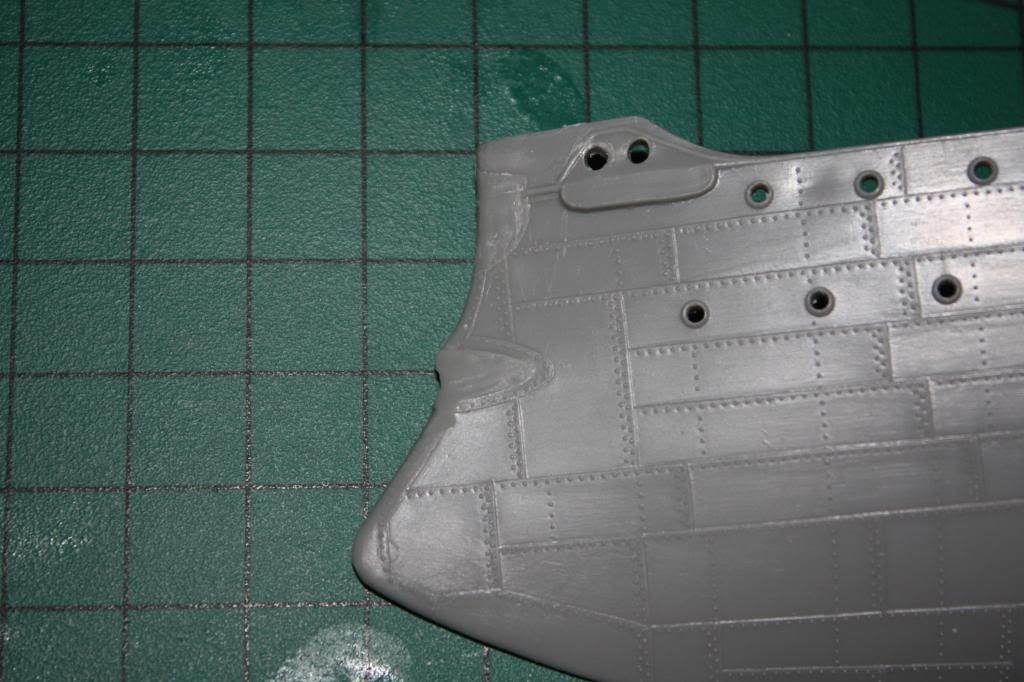

The first step in the instructions is to replace the 10 hull mounted gun barrels with brass, I have skipped that for now and moved straight to the hull. First comment about the hull is that it is covered in plates and rivets that don't resemble how this ship looks today. the hull should be smooth. I looked at the feasibility of this but it would mean removing a lot of other detail such as hatches and rungs which i could replace with evergreen card and the scuttle rims which would be more difficult to replace. On reflection I have decided to go with the easy option and levee it.
That said it has taken 2 hours tonight to to clean up the first half of the hull. The posts along the top have been removed and the surface sanded smooth, these will be replaced by etch railings. The scuttles have been drilled out as i intend to glaze them. The two little pips under each gun port have been removed and sanded smooth. The life belt cages at the rear have been removed as they will be replaced with etch. The moulded on coat of arms will be replaced with etch also so had to be carefully removed and finally the torpedo tube at the bow has been milled down ready for the resin replacement. Finally the two location pins moulded to the keel have been removed. fortunately these are in exact alignment with the stands on the base so was easy to file two half circles in ready for bolting to the stand.
That is it for nowBigGrin

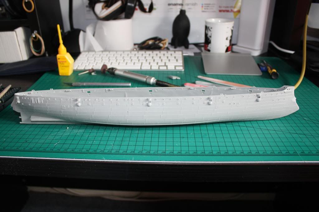

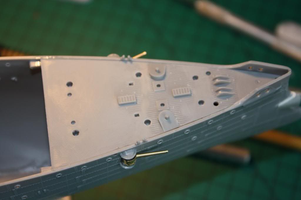

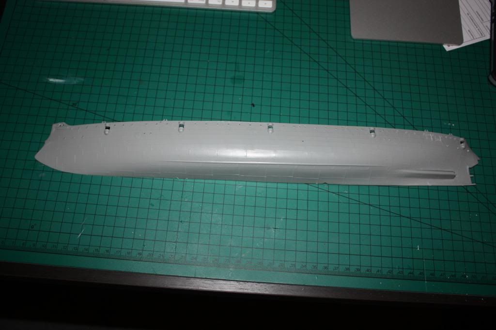

The hull sides fit together surprisingly well there are location lugs at the bow and stern which help.

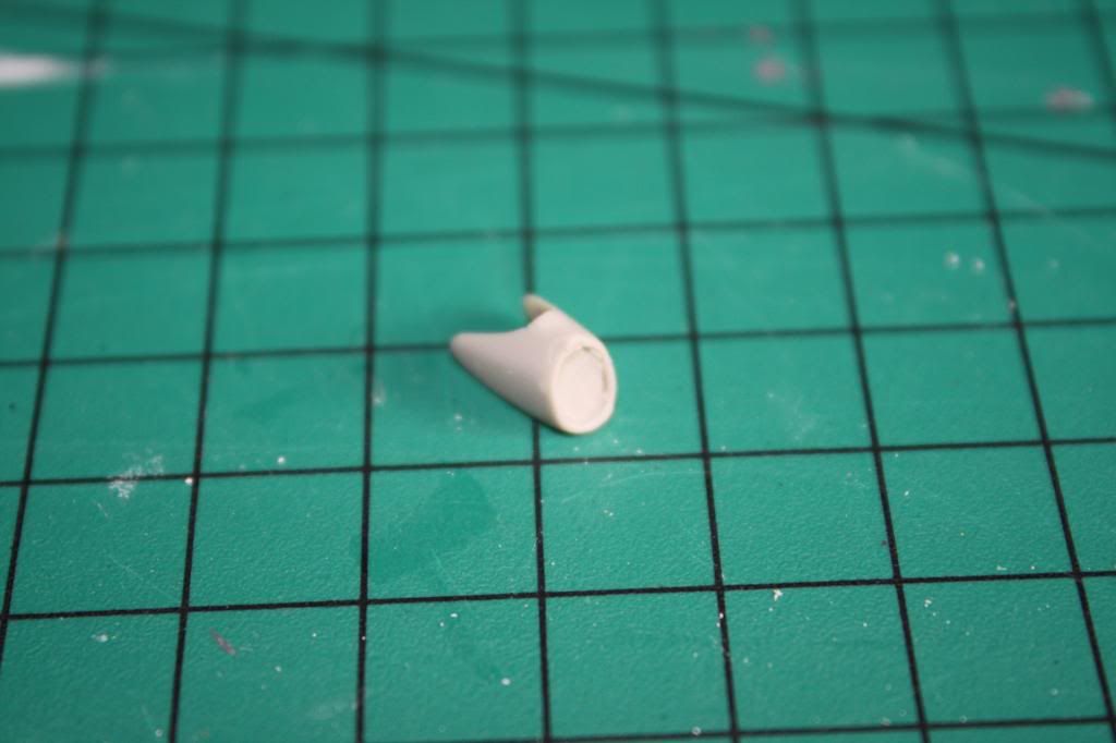

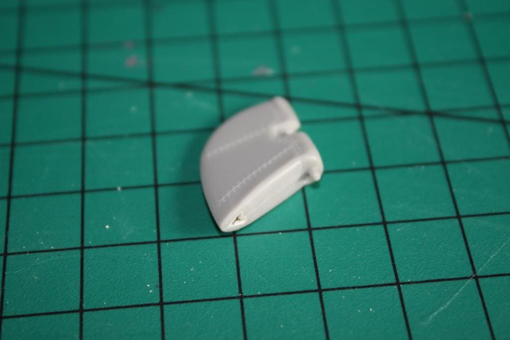

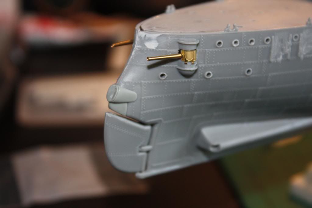

The rudder is the wrong shape and the instructions ask you to modify the rudder and fill the gap. A resin block is supplied to fill the gap in the stern.

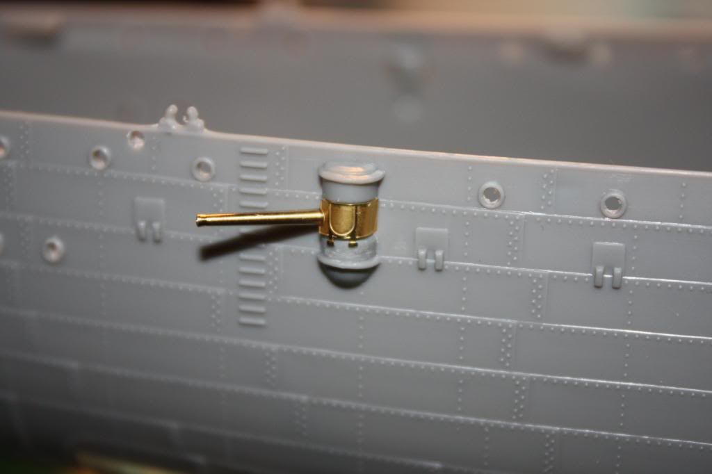

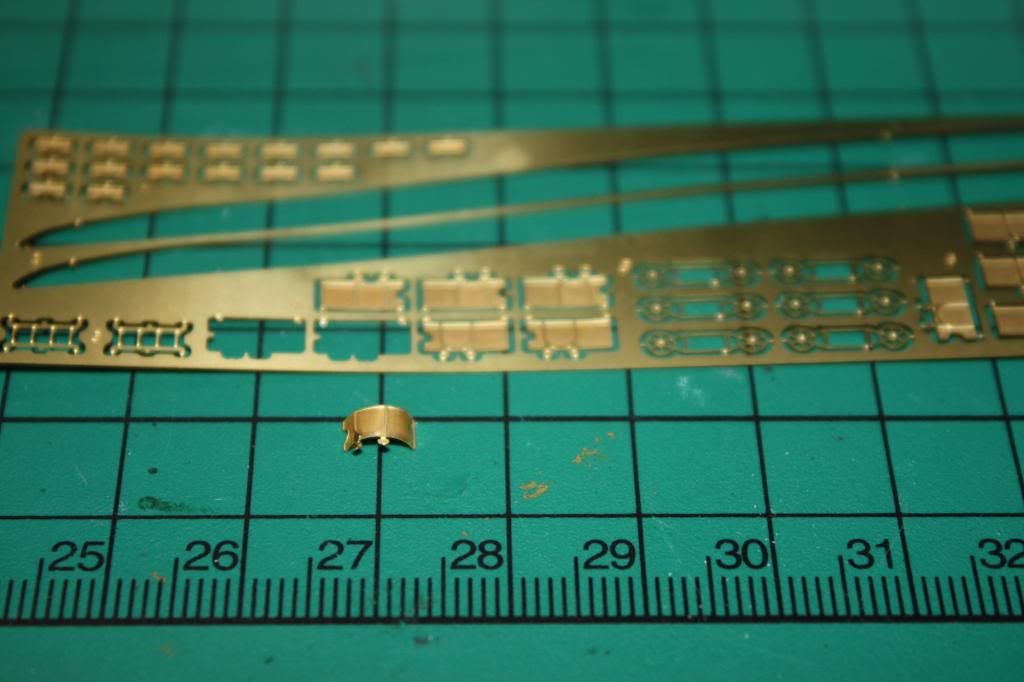

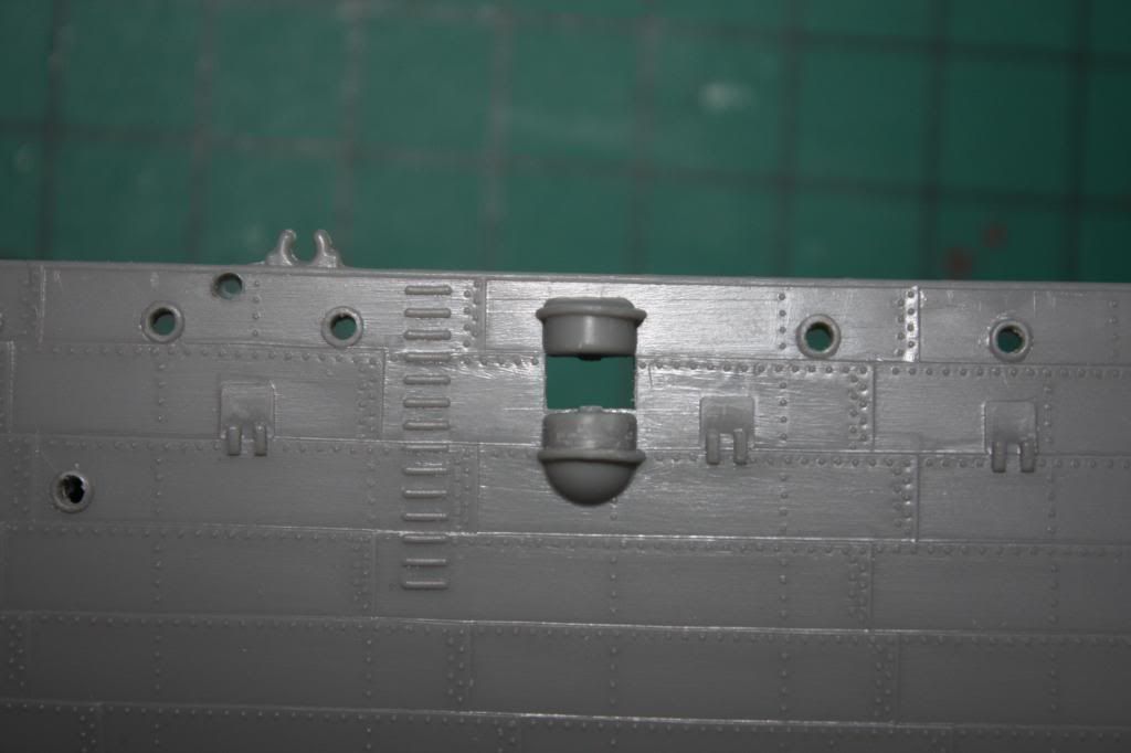

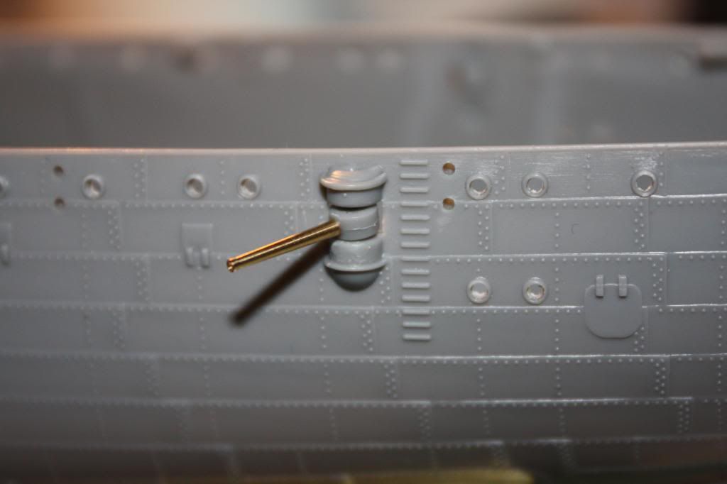

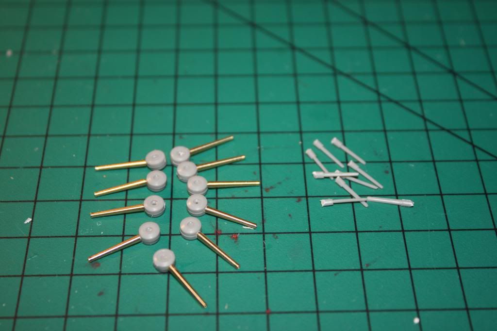

There are 10 6 pounder guns in the hull sides. Brass barrels replace the original moulded plastic ones and certainly improve the look. Once the barrels are replaced the gun emplacements just snap into position, which is how they were presented on the original kit so they were fully traversable. The kit comes with etch which improves the finished look dramatically, but at a cost of fixing the guns in position.

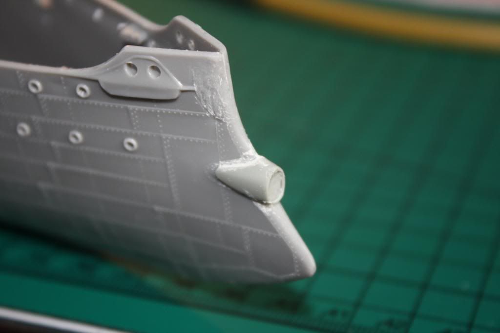

As well as the resin block for the stern there are 2 resin torpedo tubes to be fitted. he stern tube is omitted on the original kit so is a simple fit and fill. The bow tube replaces the one moulded into the hull, so the hull needs sanding down to receive the resin replacement.

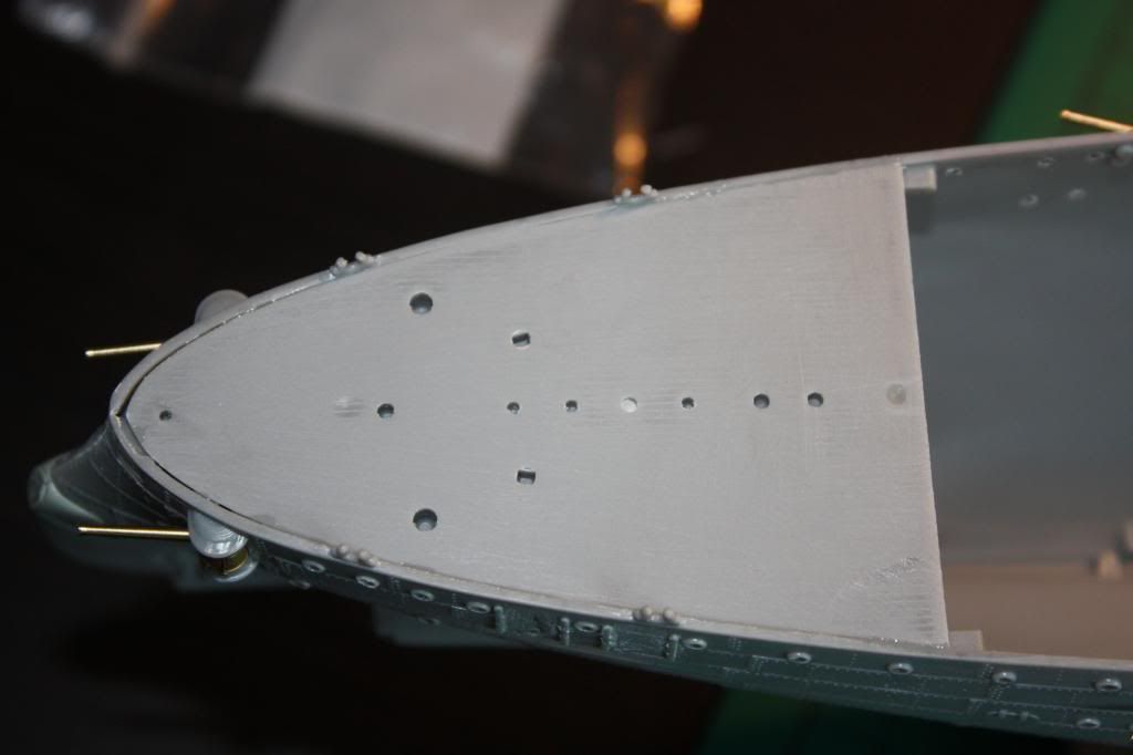

The bow deck fit was really good. I have sanded off as much of the deck raised lines as possible ready for the wood overlay, but the deck lines are very fine so not an issue.
The stern deck has a small gap but fit is still good, again the deck has been sanded.
There is some small sink on the 6 pounder tops to fill and the two resin acres to add and then the hull assembly is ready for prime and paintCool I have to say compared to other old kits I have built recently this is proving to be a much less problematic build - so farLOL
