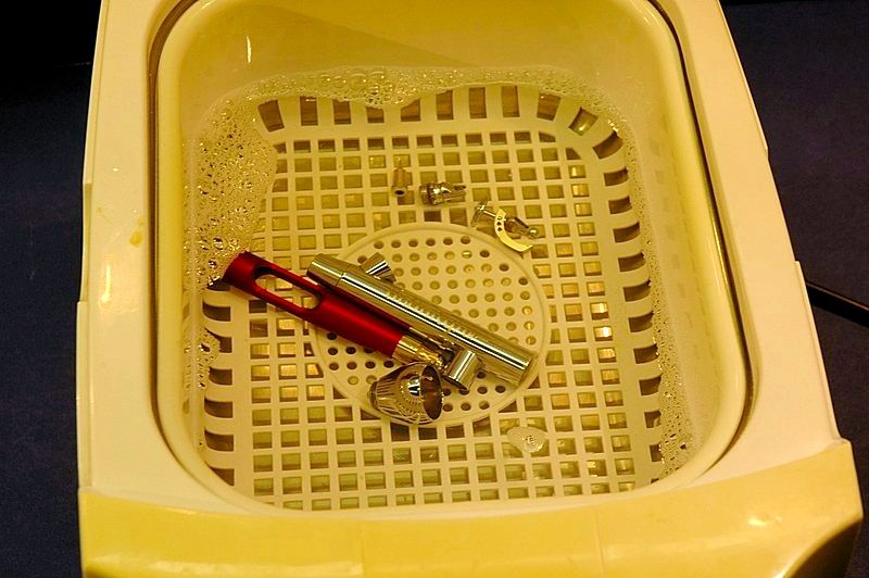

Have used one for many years for degreasing plastic and metal parts but mainly for cleaning my airbrushes once a week, I think it is the only way to clean them properly.
One thing to remember never place the entire airbrush in the cleaner! the mechanics of the airbrush has many different parts that must not be cleaned as they can lose their mechanical functions using the Ultrasonic cleaner so keep to manufactures instructions.

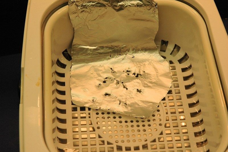

You can test the power by placing a strip of kitchen foil in the main tray let it run for 3/4 minutes to see if it has holes, if it has your cleaner will be working as it should, bearing in mind that the cheaper one's many not be as powerful as the more expensive one's.
This is my Ultrasonic:
My Ultrasonic.
Parts to be cleaned.
Foil Test.

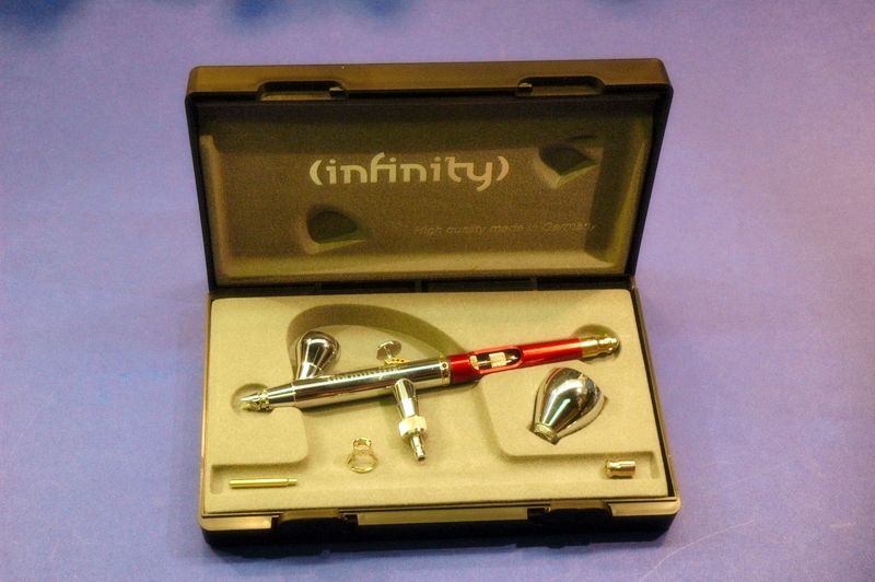

All clean and back in the box.

I started off doing the foil test that Trev mentioned and it seemed to be working fine with lots of holes developing in the foil. I proceeded to do all three of my airbrushes next using ultimate cleaning fluid. Now I thought I had a pretty good cleaning routine but was surprised by how much still came out of them. Really pleased with the purchase and would recommend one to everyone.
