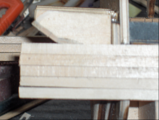

I said from the outset that I was a little apprehensive about tackling the planking. Well, up till now I have not had a problem. You usually know that when everything is going well there is a problem looming. Hers's mine.
You will see that the 5th plank is well away from the top of the gallery.
According to instructions the 6th plank should overlap the top of the gallery support. No way is that going to happen !
I can assure you that everything is as it should be. I have managed to unglue the gallery and dry fit it and it is down as far as it will go.
The only way around this problem that I can see is to cut the stern niche that the gallery slots into.
I can appreciate that not everything will fit perfectly and some parts may be a little out and require sanding and adjusting, but this is bad.
Sorry about the photo quality.

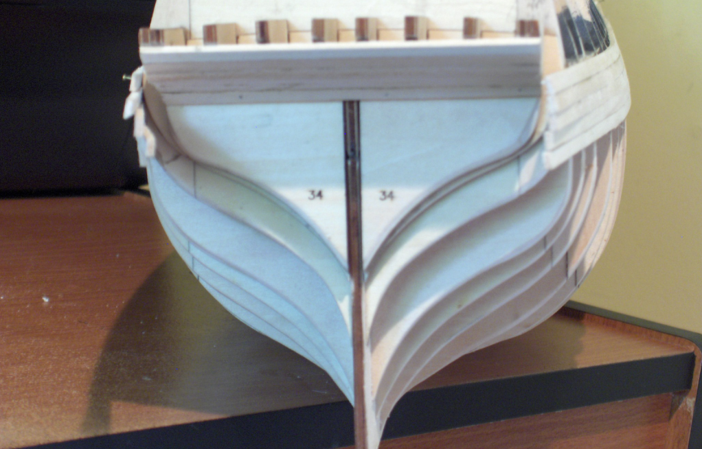

Sinbad, Please post a pic of the stern at the angle shown in Mr T's pic below. I made the mistake of pushing frame 31 down to what I thought was fully in to the keel slot...BUT, it only pushed down to as far as the top of the keel. So, basically the top of the keel right at the stern was slightly inside the slot of frame 31 thereby raising it by over a cm.
Look at the pic below and notice the 2 zigzag lines where you joined the left and right parts to frame 31, if your frame is sat too high you wont see these lines.
Steve

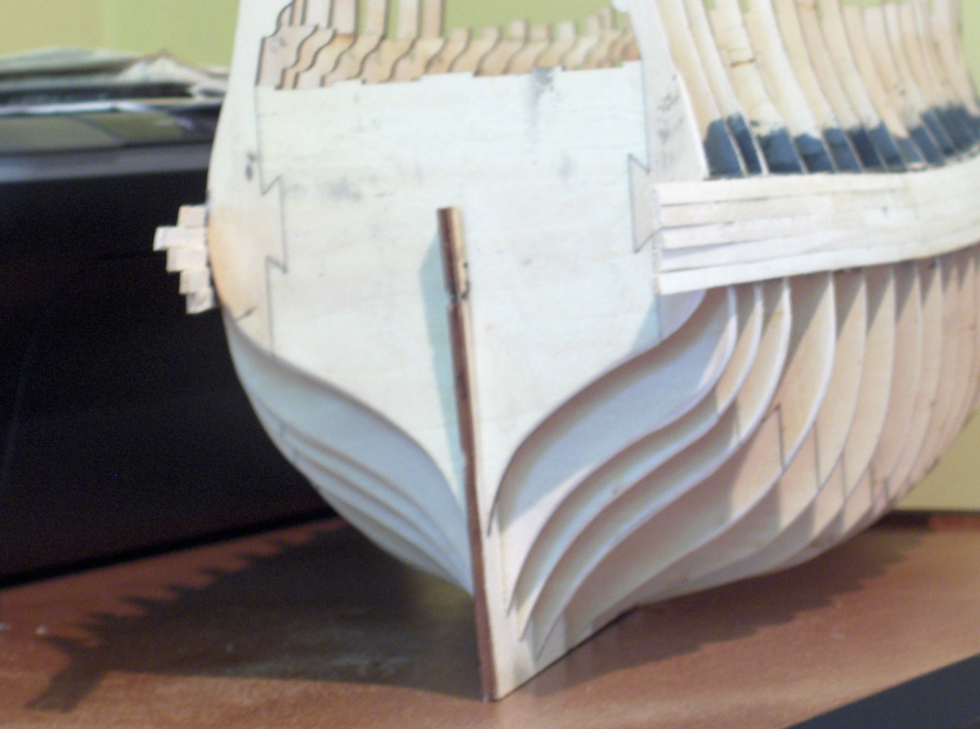

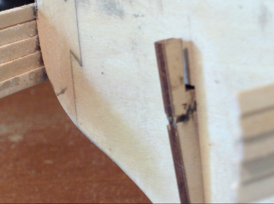

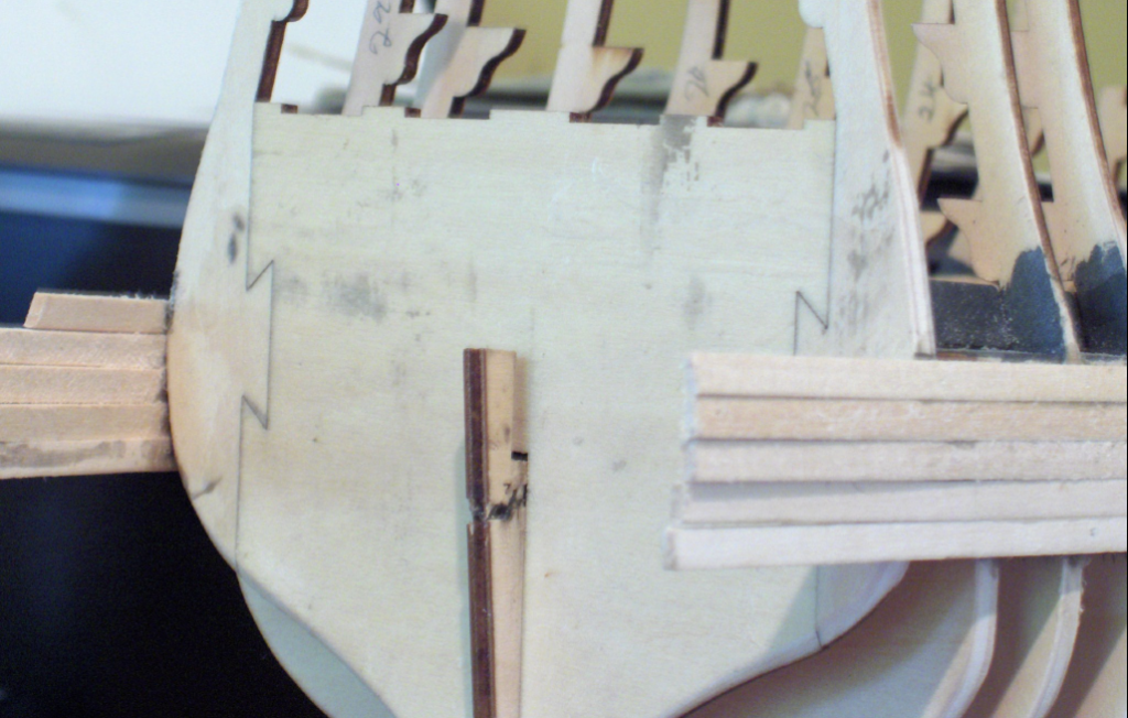

OK. Here are the pics per request.
You will see that there is a small gap where the Gallery slides dowm, but not that much to make a difference.
Also you will see where I broke The keel slot when I first tried to fit it. Again, this should not make a large difference.
Hope these help.

Sinbad, it does look like frame 31 is sat too high and not fully inserted into the slot. The bottom of frame 31 should be about inline with frame 30 at the curved part of the hull.
Also, I think you need to repair that broken keel slot correctly too as it dosent seem to be fitted right.
Look carefully at the pic below inside the red elipse - this shows frames 31 and 30 and you can see they are about level at this stage, yours are not level here.
Compare this to yours at the same 2 frames -
Steve

Sinbad, Frame 30 already looked like it was seated correctly (and I only suggested removing this one as it shares the slot with 31), frame 31 is not correct and this is the frame your supports are mounted on. You have to put frame 31 into the final slot of the keel, it's a sort of double slot for 30 and 31.
Don't base yours as being good by the height of the frame tops as these vary, they simply have to be down into the slot correctly.
It really shouldnt be difficult to sort or and now that you have soaked off frame 30 an 31 we can see whats wrong.
Please post a pic of the final keel slot without the frames (showing the keel slot repair), and another pic with frame 30 in place and then with frame 31 in place. take the pics so that I can see where the frame inserts into the keel.
The pic below shows frame 31 in place but no supports - I need you to take a pic of yours at this angle and if the keel and frame top appear as shown in the red circle then it's all good.
I would not continue planking until this is all sorted out.
Steve

OK, frame 30 could do with being seated a little lower as there is a gap, but I put this down to the fact that the keel is damaged and not repaired well at all.
My circled areas in post 12 shows very clearly that frame 31 has to come down and my guess is that it needs to come down by the entire depth of the half slot in the keel. In the same pic look how the planks fit fairly well to frame 30 showing that this is not the main problem, it could do with coming down a fraction lower but I think the keel repair will sort this. Frame 31 is way out. This is why I wanted to see the keel repair without the frames in place then pics of each frame going in as Sinbad has now said that he has soaked and removed both the frames in the last double slot.
Basically, The supports were way too high due to frame 31 not being fully inserted, and yes, this is probably due to the fact that frame 30 is also badly fitted as they share a slot.
Just to point out, I did this exact same thing with my build but spotted it before planking began, In my case though the keel didn't break, it was just that frame 31 wasn't fully inserted.
